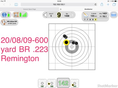

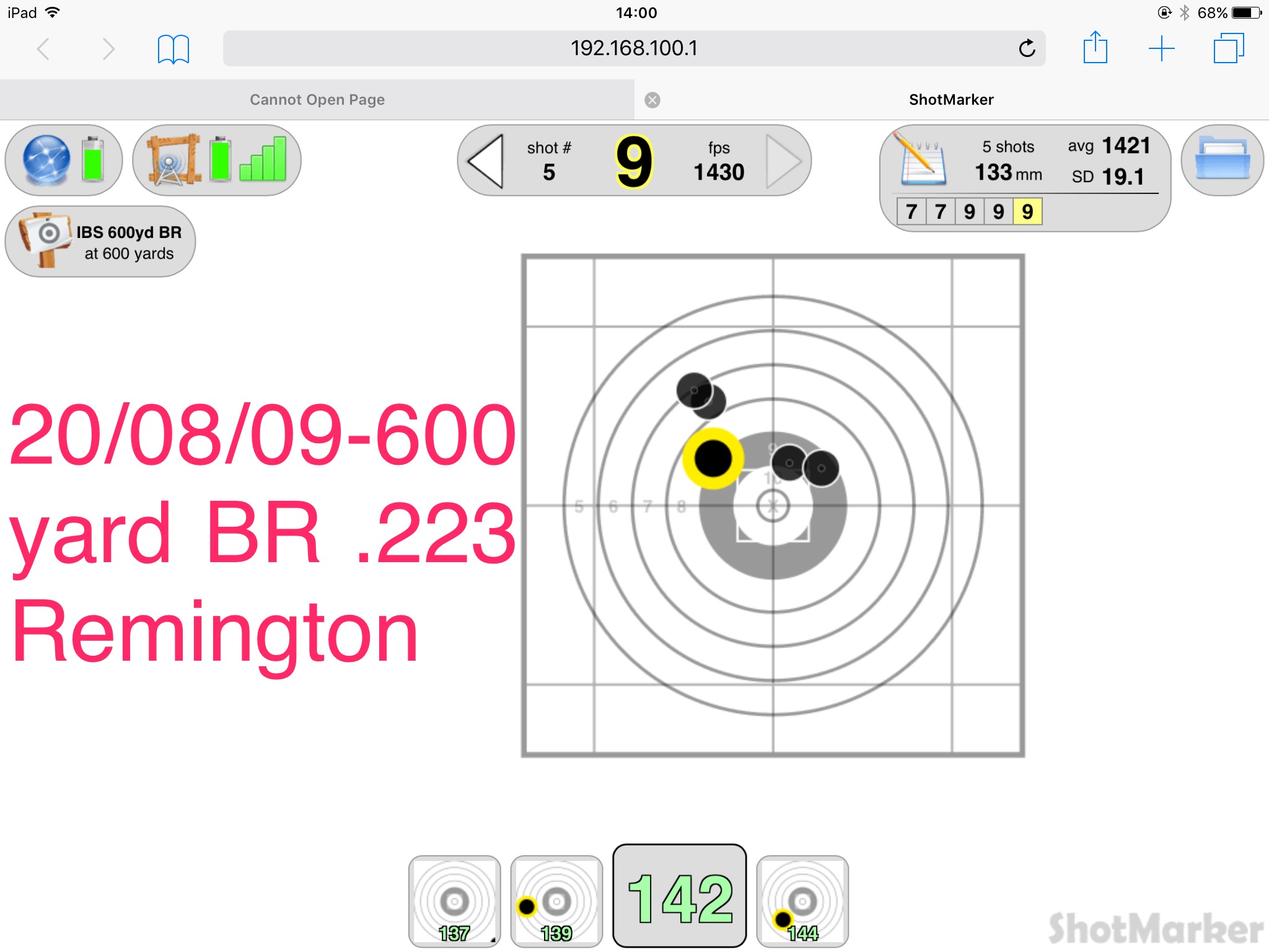

Reloading data for a .223 Remington https://www.vihtavuori.com/reloading-da ... 7/-1/-1/-1
Due to the rules I won't state my .223 loading data, however, this is a benchrest electronic target shot at 600 yards from a bipod (which I am quite happy with).

#10 Post by RJ156 »
Geek wrote: Wed May 31, 2023 10:01 pm Reloading data for a .223 Remington https://www.vihtavuori.com/reloading-da ... 7/-1/-1/-1
So just over 5” at 600yds
Some going that!
