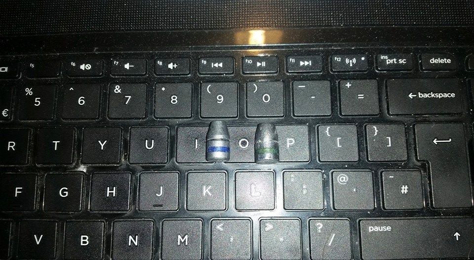

HI
founds some posts that say its fine having lead .357 bullets through a 9mm barrel.
i have some 140gr lead RNFP bullets from jon at JD reloading and some 137gr TC. would these be ok to use? and if so, what sort of load data do i need to use?
in the lyman 49th, it shows 147gr bullets, but not 140gr
here is a pic of the bullet types
any help is appriciated

#8 Post by bradaz11 »
i can't slug it yet as ovenpaa has it atm.
i'm just looking to see if there were established loadings for some out there, to enable me to empty a few mags (lead only) at the range on monday night, until i can get to the other range week after next where i can shoot fmj. also to get more time to buy some bits etc.
