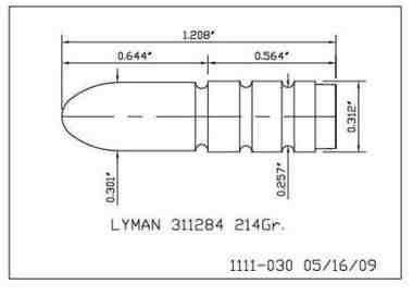

The first bullet I tried was an Eagan style, a sort of truncated nose Loverin, so next up was a heavier boolit the Lyman 311284, it has a nice long freebore filling nose as opposed to the Eagan style which just has the front driving band connecting with the truncated nose just hanging in front
This boolit came from and NOE mould and weighed in at 220 gns fully clad with lube and gas check, it dropped at 0.311" with my range scrap alloy with a smidgeon of tin, BHN 12 and was sized at 0.311".

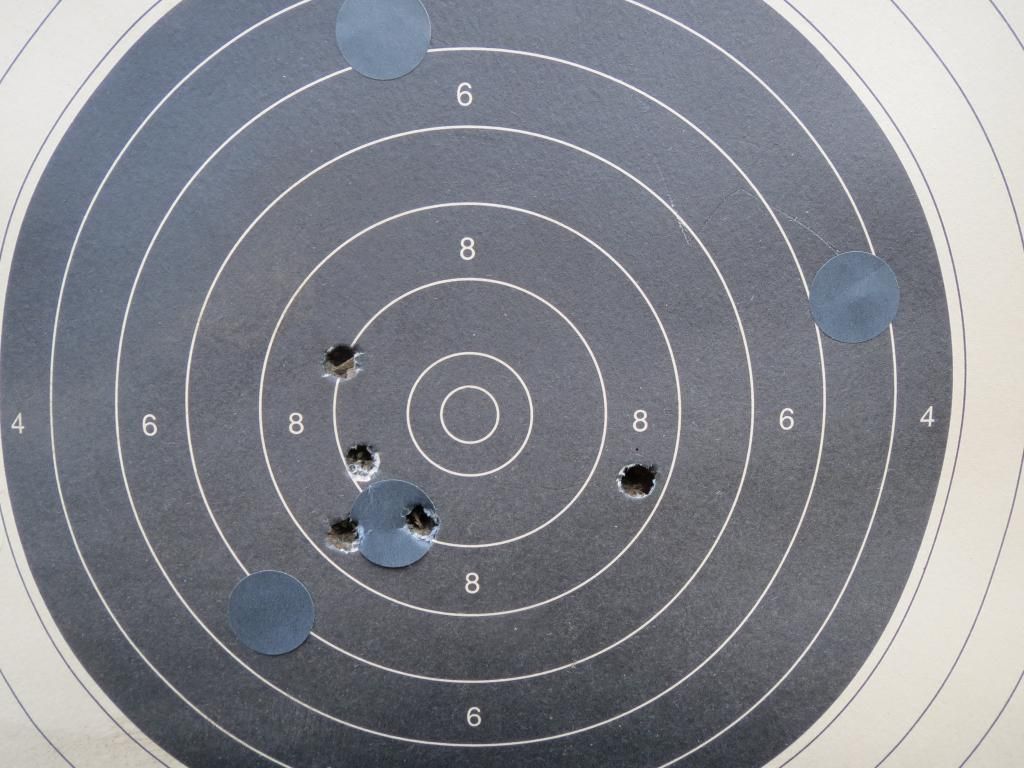

I dropped the load back to 20 gns of Ramshot Enforcer with the heavier bullet, the gave an average velocity of 1823 fps with an extreme spread of 6 fps over 10 shots.
Results were good with the first group of six rounds giving me a 2 1/2" x 1 1/4" at 100 yrds.

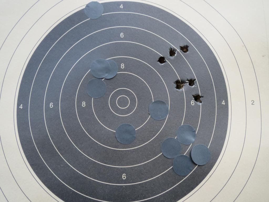

For my second group I aimed off a tad to try and centre for score and I got this group with the flier being called, usual holding to long before releasing the shot, as they say your first sight picture is always the best.

I'm pretty sure that the rifle is shooting cast well.
It is at least shooting repeatable 2" groups, the bigger groups are operator error.
With some further work I think it has the potential to be an honest MOA rifle with cast.
This would be a fine competition rifle with cast but my competition days are over now.
Just posted this to show that if you take the time to get your ducks lined up properly they shooting cast bullets gives up nothing to jacketed.
I have done no load development other than trying two bullets weights, picked a load would give me 1800-2000 fps velocity with the powder that I happened to have to hand in the desired burning rate and with a rifle in good shooting condition it delivers.
