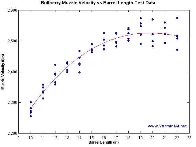

I forgot to say, other options are 20" and 24" to the best of my knowledge. I have looked for an equivalent chart for .260 as the one below is for 1.7HMR, but I can't find one. So what's the optimum barrel length for this caliber?

You don't define what you mean by "optimum" but assuming that you mean the barrel with which you can get the highest velocity, I'd infer that it's going to be quite long! I don't have an equivalent graph for 260 Rem, but given that the 308 Win is still gaining velocity with increasing length at 34" and 260 Rem is just a necked down 308, it's going to be at least as long.HALODIN wrote:So what's the optimum barrel length for this caliber?
