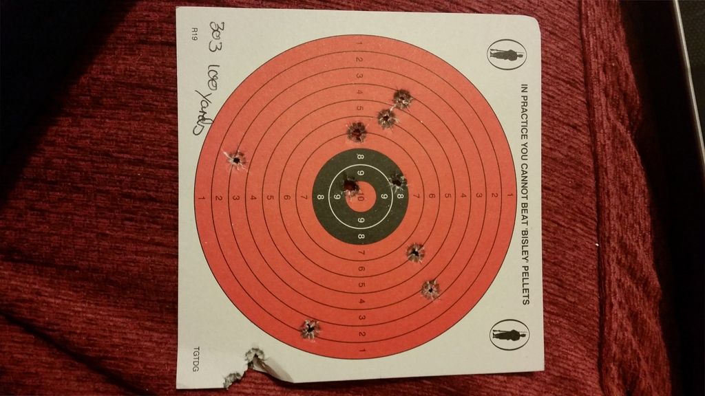

as for accuracy, its looking ok, this is with S&B 190gr rounds.
