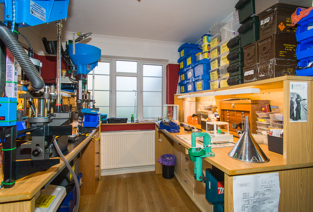

My benches came out of a commercial electronics workshop. They were given to me, so I can't point you at the source, but they have been absolutely superb; I can't recommend them enough and couldn't be happier.
The drawer units underneath are separate. Light plus numerous power sockets and network were probably (very neatly) installed by the previous owner.

Ooooh that looks pretty neat! Which Dillon is that in the foreground?

sclopetum wrote:Which Dillon is that in the foreground?
They are both Super 1050.
