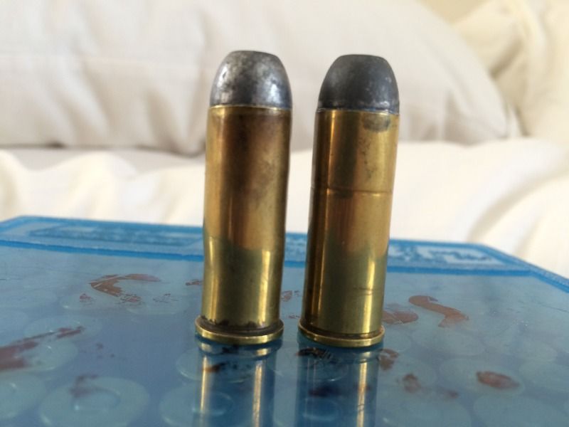

I received some .45Colt home loads once...
...can you see it?
The force that crammed the .454 bullet into the .44Mag case had actually bent the case (on the left):

Took me a minute to spot that. Surely they must have thought "this doesn't feel right" when trying to force that in.
