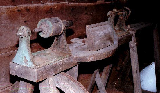

#15 Post by dromia »
This is Alpha 1's lathe.
