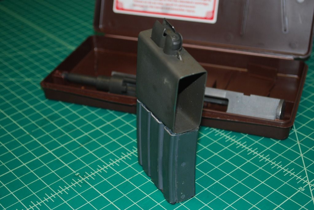

OK... Do you really think the position of the bullet at the top of the magazine (see pic above) would make that much of a difference?

Well as you can see the mags for the Ciener (type used in Spikes) present the round much higher than the M261, the Ciener bolt will skip straight over the M261 mag insert and not chamber a round.
Re: .223 mag inserts
Are you sure the BDM and Ciener mags don't sit lower in the mag well than the m261 mag insert?

John MH wrote:Well as you can see the mags for the Ciener (type used in Spikes) present the round much higher than the M261, the Ciener bolt will skip straight over the M261 mag insert and not chamber a round.

The different .22 conversion kits & dedicated uppers ALL use a mag design/feed angle unique to each design - as I am in the opposite quandry of not being able to find BDM V-22 magazines in the UK - just the M261 type and the others that they offer...
